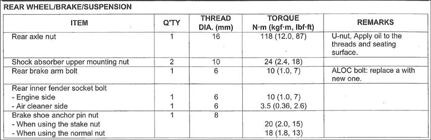

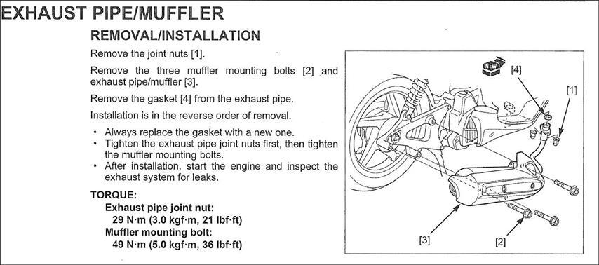

Great how-to, thanks man
I don’t have a SM - any chance you could send the torque values of each fastener?
Re: How-To: Remove rear wheel
Posted: Wed Sep 02, 2020 9:09 am
by Limey
PcxSherry wrote:Great how-to, thanks man
This help?
Snap 2020-09-02 at 09.02.29 (Small).jpg (61.88 KiB) Viewed 37862 times
Snap 2020-09-02 at 09.07.45 (Small).jpg (43.25 KiB) Viewed 37862 times
