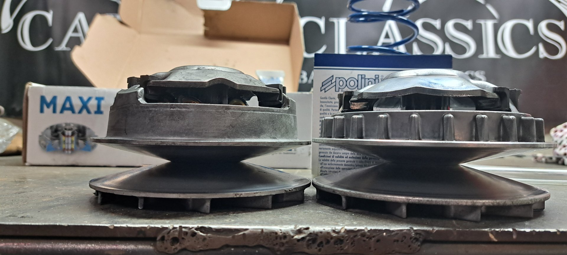

I can get substantially more from my modified stock variator running 14.5g rollers. As you can see my modified variator not only allows the rollers to travel further out but the 2 variator half's close up more too

I have a question. Which one is Stock and which one is Polini? Im guessing Left is Polini?

Both stock. One on the right is my modified variator.

Ahhh I see what you did to modify the stock driveface.. lol Didn't even notice at first.

Ah I see I never thought off it like that. I'll mark it up and test run it again tomorrow. I machined the stock variator so that the drive faces where to the centre then squared them off if that makes sense so they can close more pushing the belt out further. Also machined the stop for the variator rollers out so they can travel further out too. Can see it in the photos I added off the stock vs modded. I'm tempted to make an even more aggressive version now after all this hassle with the polini one

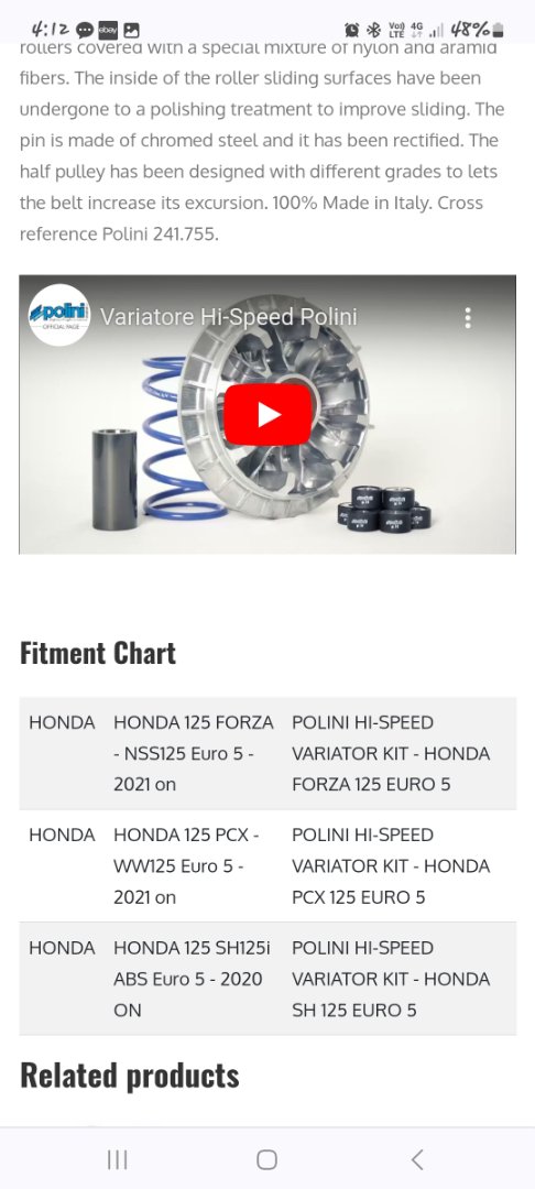

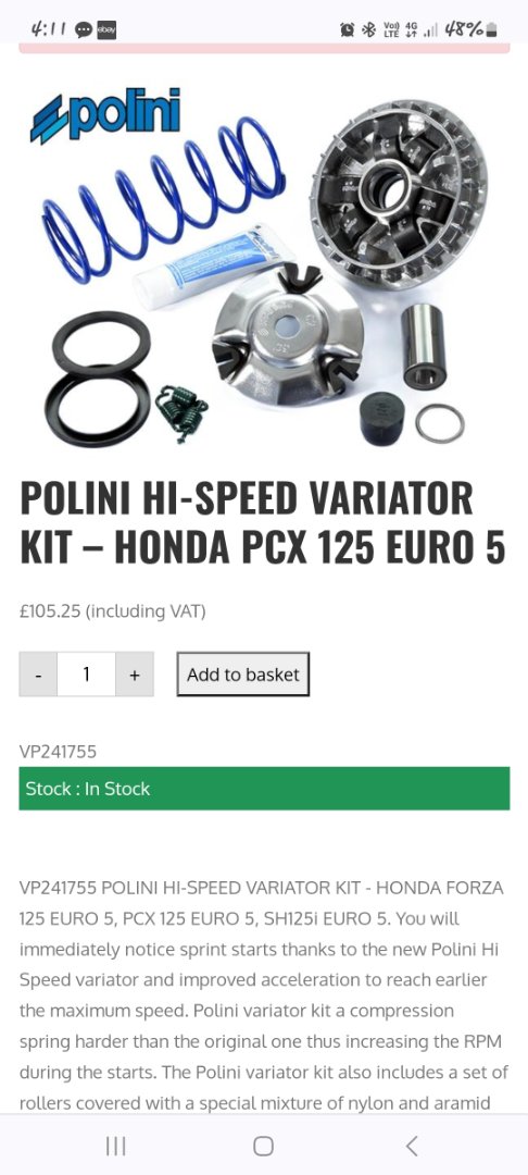

https://catalogue.polini.com/it/product ... r=products
That's the link that polini state on their site it's for the new euro 5 2021 model. I also emailed and asked and they confirmed it is the correct kit. What you say how ever makes perfect sense and explains why it's so much slower. I'm removing the polini variator tonight and putting my modified one back in so will measure the outer diameter up and let you know

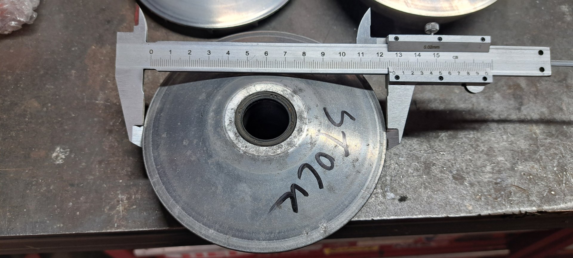

Stock honda variator is 127mm external diameter

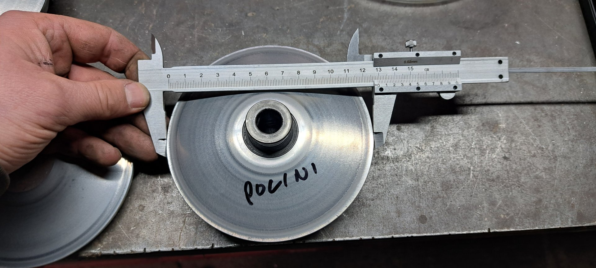

Polini variator 129mm external diameter
My modified standard variator (on left) is closing tighter than the polini one which is why I'm getting so much more from my modified variator as its pushing belt out further.
What I can't get is why the polini one doesn't. So polini ones now scrap as I've been refunded for it. So other than now modifying the polini variator I can't see how I can improve it. I'm contemplating turning the centre down so it also closes further
