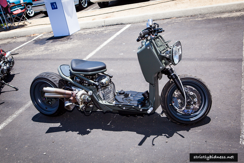

Gil wrote: It depends on how strong the engine was designed to be. All engine have a limit on how much extra HP can be made with OEM internals, some more than others. Only way to find out is to try it. No one here has done a turbo on a stock internal of Honda PCX engine, or a turbo for that matter.
Coming from the Ruckus Scene, Couple people tried Turbo on GY6 150cc engines. Not enough air to actually spoon even the smallest turbo.
Standard Functions did a Zume 125cc swap into a ruckus. Bored it out to something over 200cc and made a couple PSI of boost.

"Coming from the Ruckus Scene, Couple people tried Turbo on GY6 150cc engines. Not enough air to actually spoon even the smallest turbo.
Standard Functions did a Zume 125cc swap into a ruckus. Bored it out to something over 200cc and made a couple PSI of boost."
Thanks very cool, I wonder what turbo they used? The few project that I have seen online have also only produced a few PSI of boost.

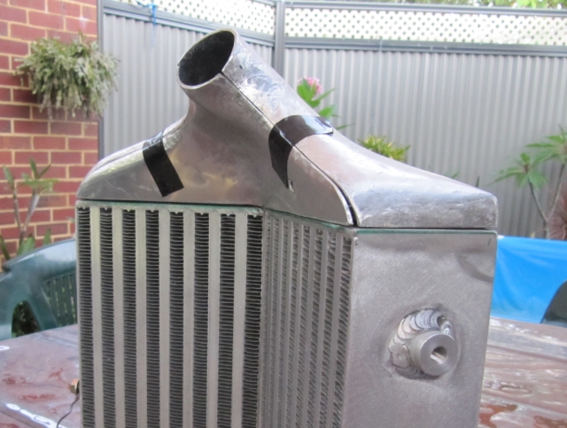

Re: Electric supercharger install
Posted: Thu Dec 03, 2020 1:42 am
by Gil
14 PSI with a single turbo, he is getting 28 hp. Look at that custom exhaust turbine housing.
https://www.facebook.com/POST100/photos ... 320498042/

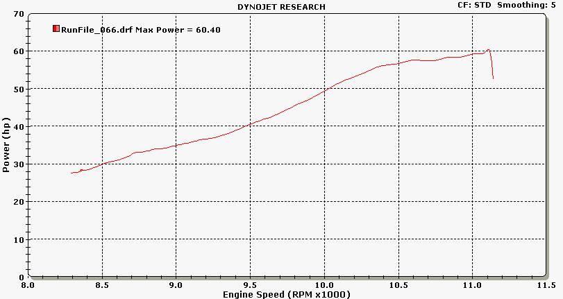

Posted: Thu Dec 03, 2020 4:22 am
by Gil
One last post. This one graph is of the stock Garrett GT06 turbo and the one with the custom turbine exhaust. The stock Turbo seems to be just right for the RPM range that our scooters run at.
https://www.facebook.com/POST100/photos ... 863442258/
Blue line is the stock GT0632.
