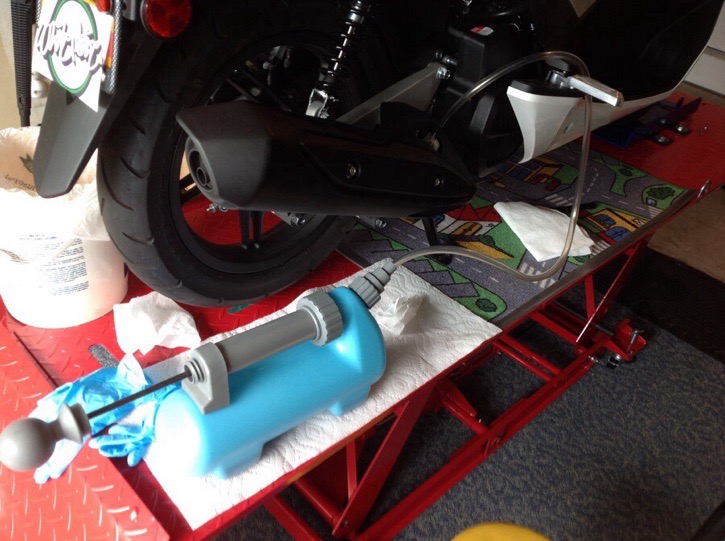

Thought I'd place these two fluid extractor's here, well....because it seems the proper place :D
(I re-use some of the extracted oil to clean tools, gardening equipment, and other misc doo-dads).
I own and have used this for oil removal: https://www.lowes.com/pd/LiquiVac-Oil-C ... em/1016407
I do Not own or use this, but it looks to do the job just fine: https://www.walmart.com/ip/TRAC-Outdoor ... r/27328297

WhiteNoise wrote:Thought I'd place these two fluid extractor's here, well....because it seems the proper place :D
Presumably you never need to undo the drain bolt then?
Nice idea, that gadget.

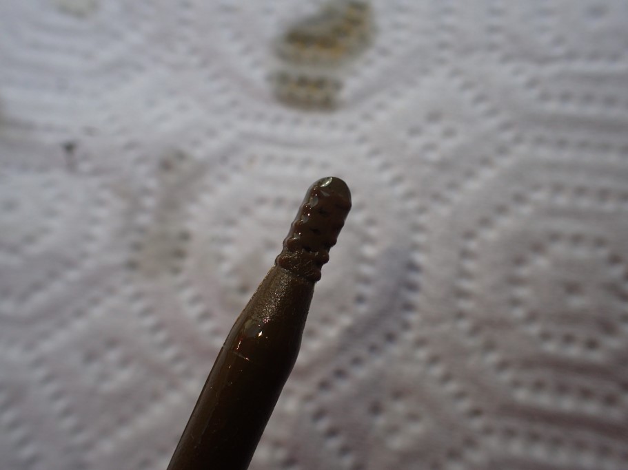

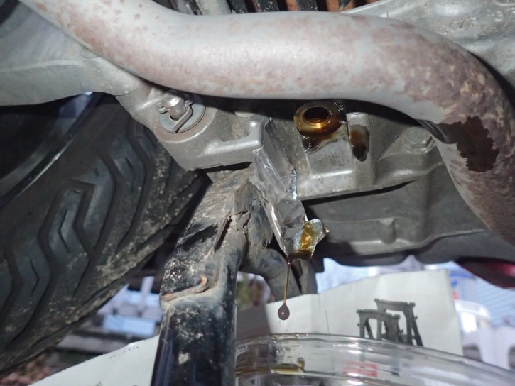

My small contribution is to stick a piece of aluminum tape to the face just behind the drain bolt. This did a great job of keeping the oil going where I wanted it.
I still made some mess, but not horrible. I did not clean the screen filter.

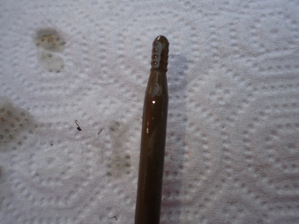

The weird thing was that I added around 700 ml of oil, then checked the dipstick, and seemed very full (oil all the way up the stick!). I measured the dirty oil and got a ballpark 750 ml (plus the mess, so maybe 780ish). I measured with the scoot on the center stand. I also ran out of daylight, and so will further investigate tomorrow morning.
So - proper measuring technique is scoot reasonably flat fore and aft, on side stand, dipstick just placed into hole, and oil only on the crosshatch part of the end. Do I have anything wrong?

Did you start the engine, let it run for 2mins, wait for a little bit and recheck?

by GeorgeSK
Good tip, You². Let it run for a bit, checked, and needed to top up a bit more. Still overdid it. You need narrow tubing to get in to suck out the excess (1/4" OD worked - 3/8" did not). Perhaps I'm being too anal, but level is very finicky - 40 ml makes a big difference.
And 40 ml later:
