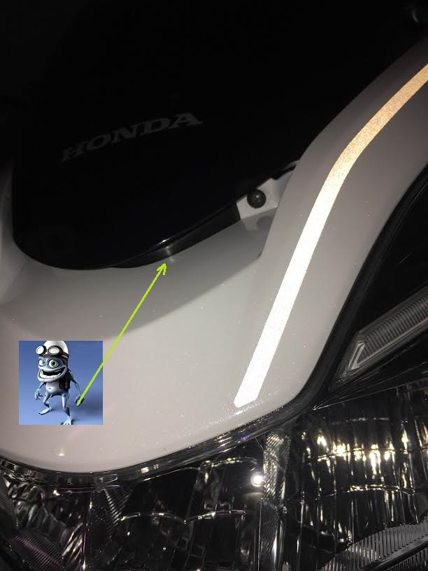

Hi there.Ishkabibble wrote:I don't know if this will help, but I think I know what is causing the buzzing sound in Natasha.
It's the meter panel under the windscreen. There's one point on the panel, at the most forward place on it, where it just barely touches the brow fairing. That is where the buzzing is coming from on Natasha. A small piece of rubberized tape to cushion between them, and no more buzzing.
I have no idea about the buzzing from the rear. I'm not even going to go there.
Kindly could you indicate by showing us an image please.
Thanks
Re: PCX125 buzzing sound, very annoying
He means this I think, good to know if true. Easy enough to test this by blocking the intake.Andreapcx wrote:Hi there.Ishkabibble wrote:I don't know if this will help, but I think I know what is causing the buzzing sound in Natasha.
Thanks
- front.jpg (82.25 KiB) Viewed 5381 times

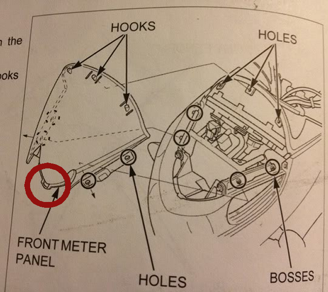

Yep, that's exactly where I mean.
There's an "open tab" on the bottom of the meter panel that is supposed to fit over a tab on the brow fairing, I believe, and it never stays in place. So I put a small piece (about 3/4" square) on the front of the tab to serve as a cushion. End of buzz.
- Location of front of Meter Panel.
- meterpanel.png (407.01 KiB) Viewed 5360 times
