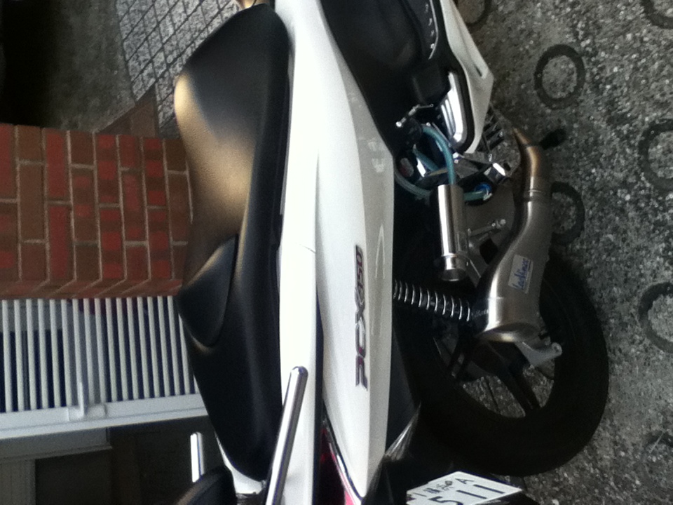

Update: I have the LV Cobra SS exhaust installed and a tachometer. Power feels good throughout but I have lost a few KPH on the high end, now only getting 105 to 110 max. I have the 12G Dr. Pully Sliders in with the NCY kit. RPM's at WOT on highway max at 4800. Should I go lighter or heavier with the roller weights? I am guessing Heavier at this point.

Scompton1 wrote:Update: I have the LV Cobra SS exhaust installed and a tachometer. Power feels good throughout but I have lost a few KPH on the high end, now only getting 105 to 110 max. I have the 12G Dr. Pully Sliders in with the NCY kit. RPM's at WOT on highway max at 4800. Should I go lighter or heavier with the roller weights? I am guessing Heavier at this point.
Your tach must be set to the wrong number of cylinders. 4,800 is probably half of what the real reading is at 9,600. That is the electronic rev limit. The rollers have nothing to do with that. You want to set the weights so that you are at 8,000 rpm when you pin the throttle at speeds between 20-40 mph, 30-60 kph.
I don't know why you have lost top speed with the exhaust if the engine is still redlining. RPM versus top speed should still be the same.
Keep in mind that it may take a few days for the engine to adapt the mixture to the new pipe.

New LV Cobra SS pipe
Sendler, thanks for the reply. The tach is digital and designed for scooter/motorcycles. Not sure what that means. I will give it a few days to stabilize. I am just not sure that I have the transmission components fully balanced yet. It sounds great with the new exhaust. The shop thinks I have too light a weight for rollors, he thinks I should be using 15g minimum. I may give that a try if top speed does not improve over the next few trips. It is definitely more fun to drive than it was with stock.
Read the instructions on how to set the tach correctly..there are options for 4t,2t...try 15g rollers and see what it does.

Two things, I have heard of a top speed loss with the full NCY kit. Maybe it's in the contra spring? Swap the stock one back in and see what happens?
Also, did you shim the variator? This is essential to the NCY kit.

get your tach set up so it is reading right. It is reading half value right now. Then do some pulls. You should see the rpm go quickly up to a near steady value and stay there until you reach 50 mph or so. then it will begin to rise linearly with speed showing that the weights are all the way out. Which means they are not too light. the rpms will continue to rise with speed until you either run out of power and top out ar you hit redline at 9,600 rpm.
Put the stock contra spring back in. A super stiff spring squashes the belt and makes it narrower as it is running through the pulleys robbing top speed. And heats it up more causing wear and wasted power. Lighter weightd do the same thing as a stiff contra spring to raise the pulling rpm. Without the drawbacks.
