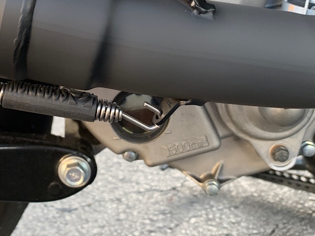

Nice find… Good install… Your stainless pipe that comes out of the engine eventually will turn brownish/rainbow from the heat. Mine did on my scorpion.( and every other pipe I’ve owned ) Take it off, wipe it down with acetone and paint it with a high temp flat black paint ....looks like this when you’re done.
