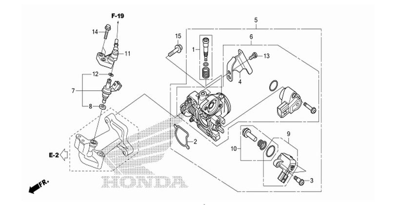

I installed my BBK today. However there's a problem. The yuminashi 31mm throttle body do not have an idle adjusting screw (For my scooter, PCXs are fine I guess).
And also there's a solenoid and valve setup on top of my stock throttle body. like in this image.
number 9 and 10.
It's a solenoid valve, I think it's adjusting the idle in some sort, or just adjusting the amount of air getting into the engine when the scooter is not in idle.
However, on the Yuminashi throttle body and based on their image, they do not install this solenoid valve into the 31mm throttle body and just leave it there.
I tried to start the scooter expecting flashing check engine light but NO. Nothing happens, the scooter starts easily, with an unplugged solenoid valve. I figure it's not a sensor so it's bypassed?
Can I install my stock solenoid valve on the Yuminashi throttle? I did not check it but it might fit, but again still no adjustment screw?

That is the IACV (idle air control valve). It is automatically adjusts Idle air and this is the reason why there is no manual idle screw on the throttle body.

My stock throttle body an air adjustment screw. My scooter is a click 125i, it does not have IACV but only a solenoid valve? I think they're the same but don't know why on the pcx it's fully automatic and called IACV but on our scooter it's just named "solenoid valve" and we have an idle air screw? Really not understanding what the solenoid is doing on my scooter ?
The idle air screw on my stock throttle body is part number 1 in the above mentioned picture.

From my expirience, Yuminashi tb comes with no pre installed sensors, you need to take them off you stock tb and install them back on 31mm..

On the Yuminashi 31 TB there will be an IACV sensor, which is the black thing on the back. If you guys run a PCX, there will be no hassle I guess, install your old sensors on it and boom work like a dream.
My scooter does not have an IACV sensor but a simple solenoid valve and a manual idle air adjustment screw, manual as in carburetor style manual.
This is how Reggy told me to do it. remove the IACV from his TB. In theory, the IACV works by electric, pushing the piston inside in and out to close/open the air inflow which bypass the throttle plate to help the engine idle. But the IACV piston can also be turned by hand inside or outside, as a measure to remove it and fix it if it runs into problem. So I remove it and turn it counterclockwise 3 times, insert it in, because the piston has a ramp to be fixed into a copper thing inside the TB, it does not change its position. and since there's no electric applied to it, it'll stay that way forever and help my idle to be stable at 1800 rpm.
I really had a good laugh and complimented Reggy for turning something that is supposed to be electronically controlled into a simple idle air adjustment screw. In my book that's street smart at its best.

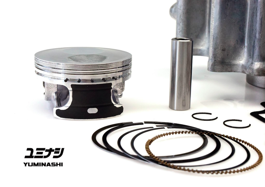

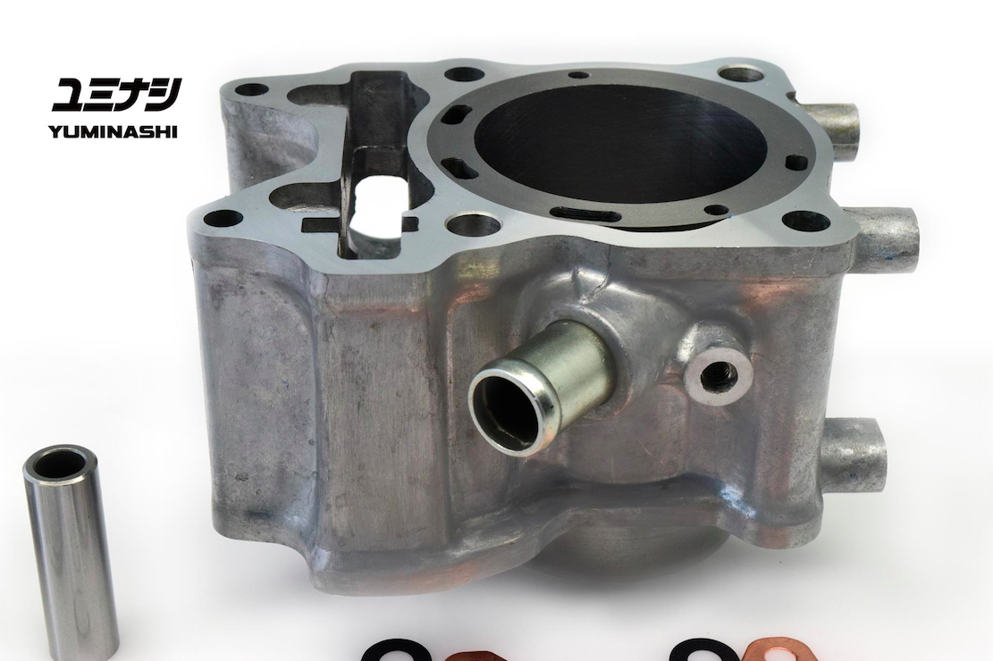

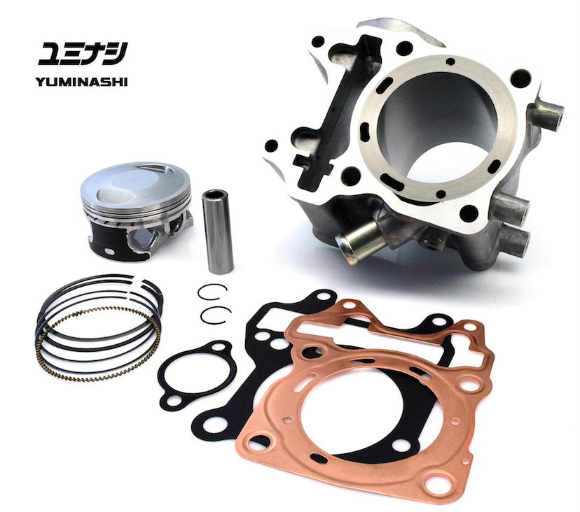

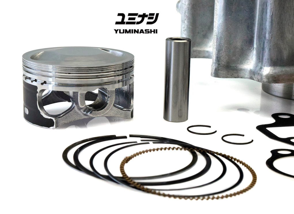

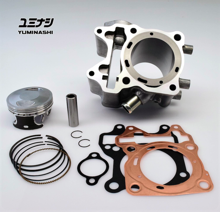

I spoke with Reggy the other day, he had this for us. New piston with higher dome for more compression, this is for the guys who wants to run the PCX150 head with bigger valves since the combustion chamber from that cylinder head is bigger, therefore less compression..
He also talked about a flat deck cylinder, which I think he meant for better protection against gasket leaks..
Here are the pictures he sent me yesterday.

The new kit looks really sexy. The full top sleeve is usually used in high power engine applications - helps to control cylinder sleeve vibration and distortion under load, and also provides better cyl head sealing and more resistance against the issues caused by the different heat extension of steel and aluminium composite materials.
Re: PGM-FI Controller for first generation PCX150 (KF12)
Posted: Thu Jan 07, 2016 2:03 am
by BPT7594
Oyabun wrote:The new kit looks really sexy. The full top sleeve is usually used in high power engine applications - helps to control cylinder sleeve vibration and distortion under load, and also provides better cyl head sealing and more resistance against the issues caused by the different heat extension of steel and aluminium composite materials.
The price is steep though. And the compression from this kit when used with a pcx150 head is even higher than a flat top piston (more than 12.8). Reggy really pushes everything closer to the edge this time.
:? I know he tries to be as safe as possible but I'm still scared of running too high compression o_O
