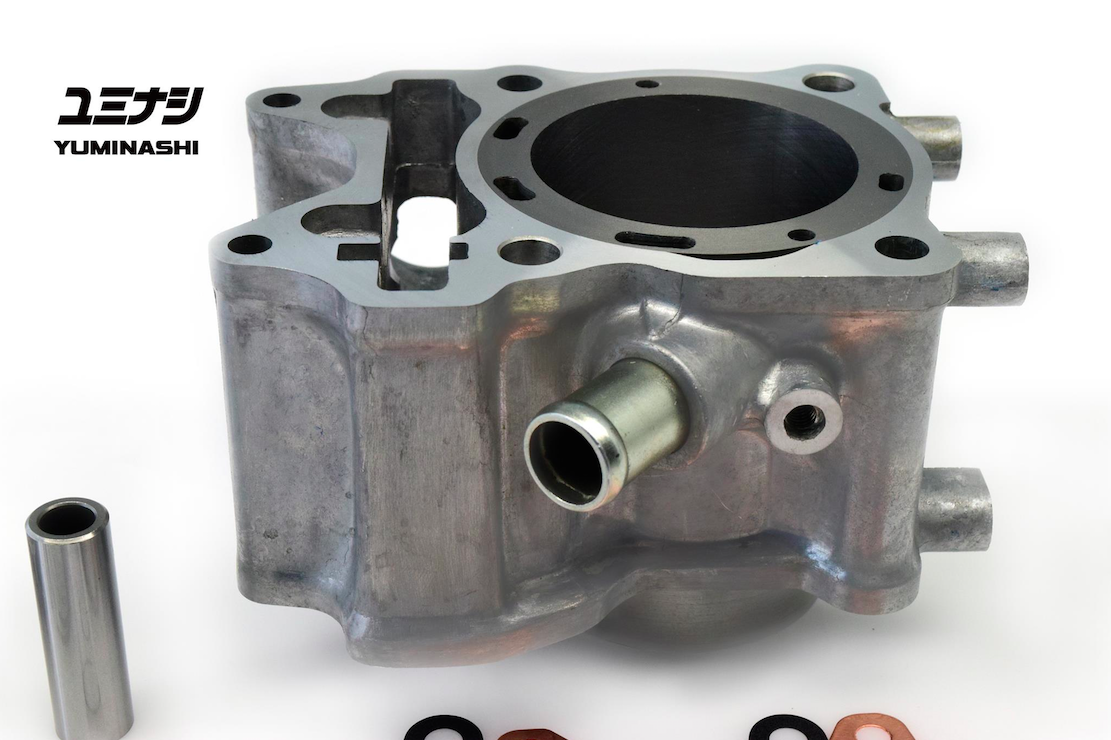

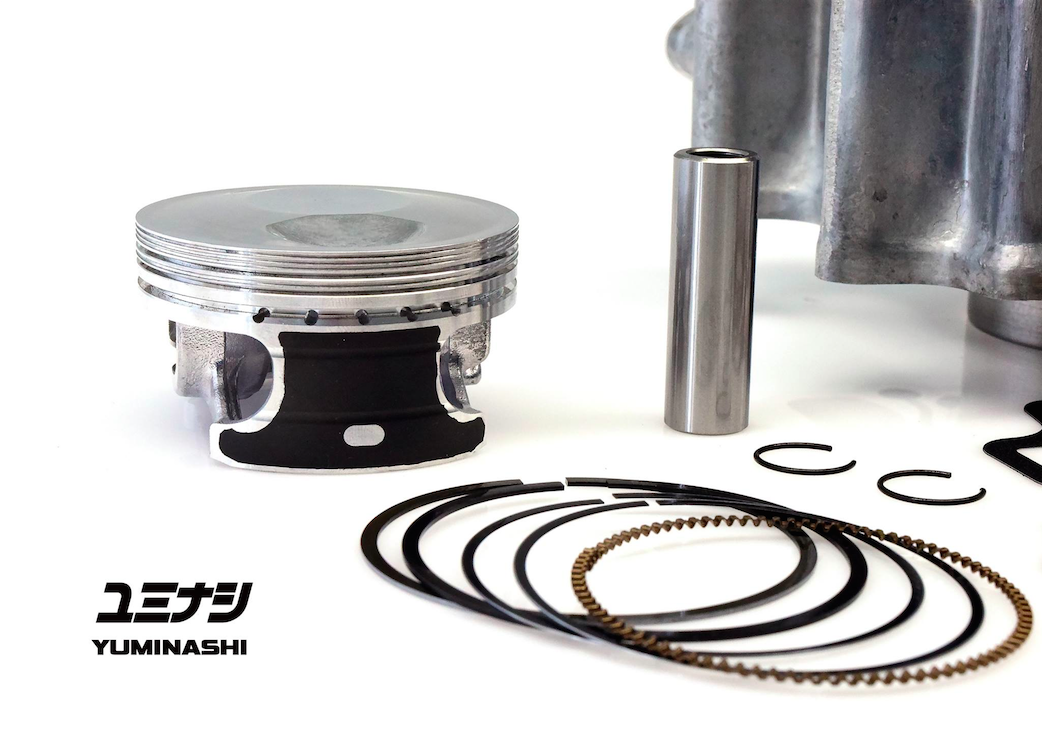

I spoke with Reggy the other day, he had this for us. New piston with higher dome for more compression, this is for the guys who wants to run the PCX150 head with bigger valves since the combustion chamber from that cylinder head is bigger, therefore less compression..
He also talked about a flat deck cylinder, which I think he meant for better protection against gasket leaks..
Here are the pictures he sent me yesterday.

The new kit looks really sexy. The full top sleeve is usually used in high power engine applications - helps to control cylinder sleeve vibration and distortion under load, and also provides better cyl head sealing and more resistance against the issues caused by the different heat extension of steel and aluminium composite materials.
Re: PGM-FI Controller for first generation PCX150 (KF12)
The price is steep though. And the compression from this kit when used with a pcx150 head is even higher than a flat top piston (more than 12.Oyabun wrote:The new kit looks really sexy. The full top sleeve is usually used in high power engine applications - helps to control cylinder sleeve vibration and distortion under load, and also provides better cyl head sealing and more resistance against the issues caused by the different heat extension of steel and aluminium composite materials.
