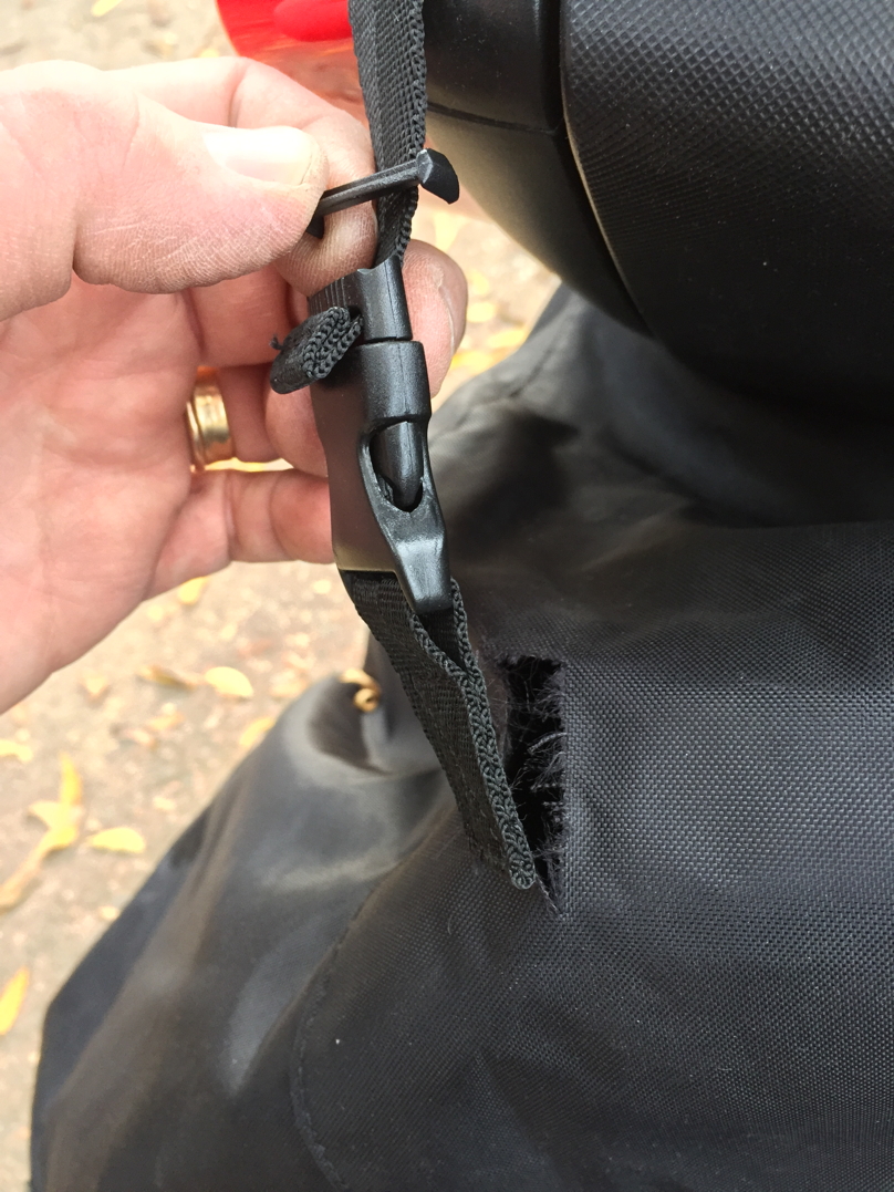

I went to install the Tucano Urbano leg cover (Thermoscud R164) for its second season. First I had to stitch up the cut I made last year for the parking brake lever that is on the US model but not on what is sold to most of the rest of the world. Then, when I was almost done, I went to tighten the straps that go across the dash and under the windscreen. The one on the left side failed in two different ways.
First, a piece of the plastic buckle broke off. Second, the fabric of the leg cover ripped. Cf. the first picture below. So, I just spent a long while outside repairing things with a sail needle and dental floss. That's right, I used dental floss.

So, here's the damage:

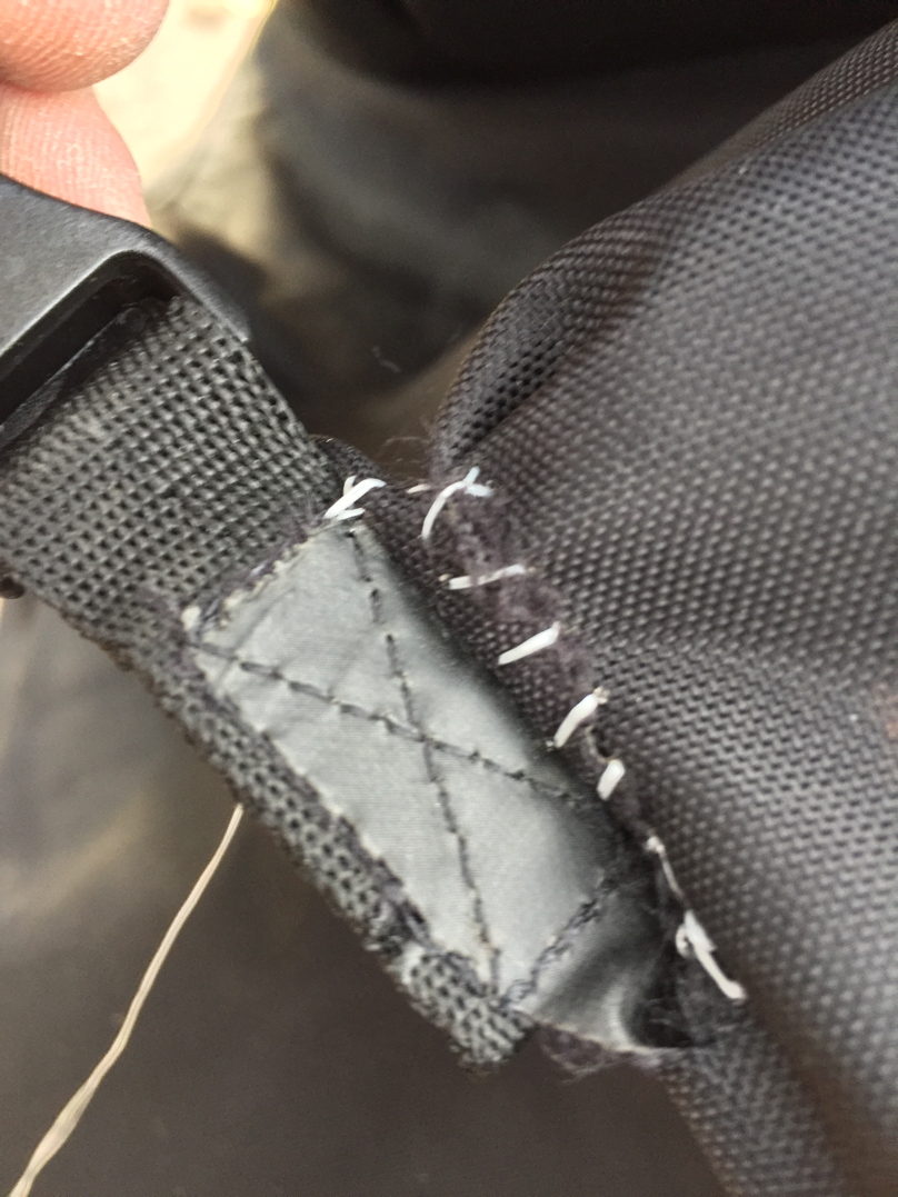

Here's the first stitching, just closing up the hole in the Thermoscud's fabric:

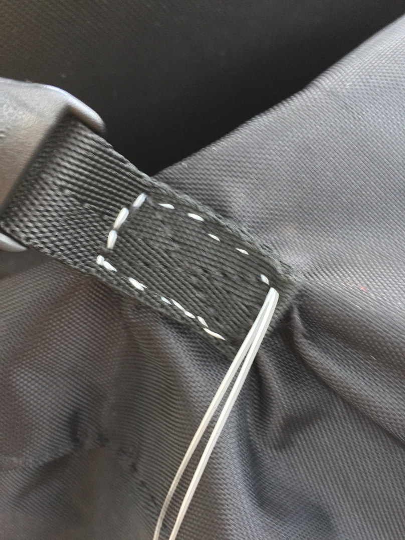

Here's the first line of stitching from the top:

I then stitched the end of the strap up because the tension buckle had broken (cf. first picture. The completed job looks like this:
