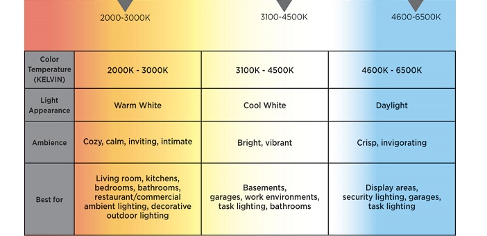

Re: flashing headlight
I would propose an industry standard temperature color rather than any oscillating headlamp. Separate our limited forward illumination in a crowd of headlights at night. The best way for the mind to alert and notice a biker is color and watts IMO. I wish there were restrictions on auto's to 3500k and all motorbikes would come standard with 6500k
This would clearly do the job, unfortunately we don't have the lobby or power to make such laws. I don't want cars using the blue lights even when I'm in one... but i always notice them.
- color-temperature.jpg (62.95 KiB) Viewed 4460 times
