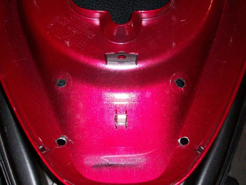

I bought a 2011 PCX and someone has already drilled out the wholes in the back. The front two close to the seat are the same as the ones in the images. However the ones in the back are the smaller wholes next to the big ones. Does anybody know of a trunk model that will fit in these wholes?

Do you have any pictures of the holes?

Here you go!
