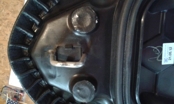

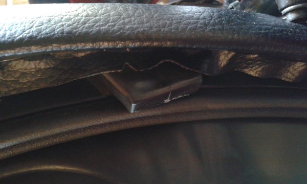

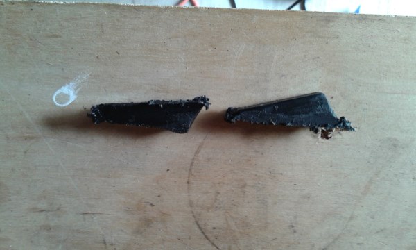

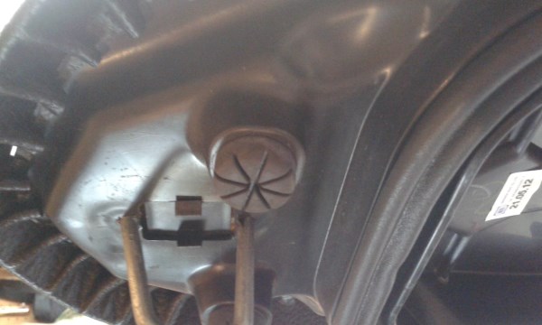

Here is a quick easy way to lower the seat 1/2 inch. It might not seam like much but it is noticeable once you sit on the seat.
There are 2 plastic stops on the bottom middle of the seat, simply cut them off with a disk grinder or dremel tool or soldering iron or..... and then remove the 2 rubber bump stops at the rear of the seat. After you cut the stops off it will not drop the seat until you sit on it. You can leave the rubber stops if you want the seat will just flex a little more.
