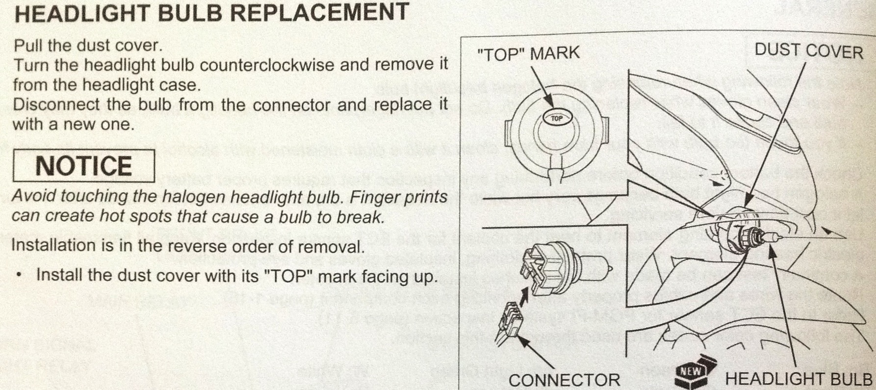

 ), I have a picture from the manual to share too
Re: Replacing A Headlight Bulb
From the look of the picture Whitenoise, it does look like Thai bulbs are different than US ones (and possibly the rest of the world too)
