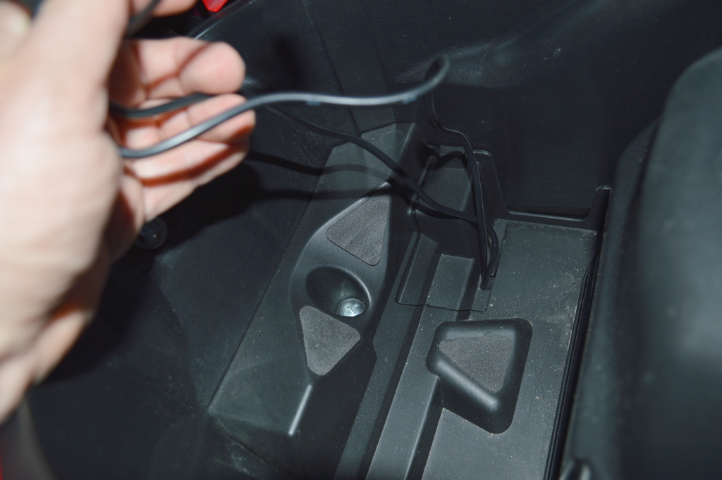

MichRocks is exactly right, we should all have a permanently installed battery tender connection, and the bike should be plugged in whenever it's going to be idle for a while. However, getting inside the battery box is tough, and finding a route for the cable requires removing several of the plastic body panels. So it may take me another week or two before my cable is connected.
Re: Battery question
Actually, I cheated...I didn't remove any panels. Once the battery lid was off, I notched the lid, then snaked the cables through it, and replaced it, leaving the cables in the storage compartment. I wrap them up with a tie-wrap (wire), then put them in a baggie so they don't get wet from my boots when it rains. Works well so far...but that's because I'm lazy as hell!mboni wrote:... However, getting inside the battery box is tough, and finding a route for the cable requires removing several of the plastic body panels. So it may take me another week or two before my cable is connected.
