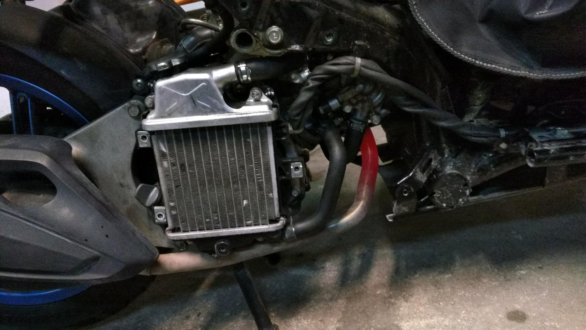

Installed Yuminashi full set of 164cc. I put a long gear 15/45. Started driving. In a few days I drove 180 km. Then the scooter started overheating. The red light came on. I pumped the water system many times, the result is deplorable. The steam is collected, the pressure in the radiator, the liquid is sent to the expansion tank. It does not return when the engine is cold. I changed the thermostat, checked the pipes, hoses, pump seal. No air leaks found. Could it be the head gasket?

Valeriy7 wrote: Wed Jan 19, 2022 8:06 am Installed Yuminashi full set of 164cc. I put a long gear 15/45. Started driving. In a few days I drove 180 km. Then the scooter started overheating. The red light came on. I pumped the water system many times, the result is deplorable. The steam is collected, the pressure in the radiator, the liquid is sent to the expansion tank. It does not return when the engine is cold. I changed the thermostat, checked the pipes, hoses, pump seal. No air leaks found. Could it be the head gasket?
by the symptoms the joint must be gone !!
I almost bet you are using the original 1.1 bar radiator cap!!! if this is one of the problems, another cause could be injection.. lack of gasoline causes overheating / engine clogging

Radiator cap 1.6 bar. Injector 170 cc see Throttle Body 31mm. Collector, air filter and its pipe included. Camshaft and rocker arms with double springs. FI CON2 Takekawa (previously Takekawa 170cc kit, now Yuminashi 164cc). Candle NGK9. Yuminashi CVT and long gear 15/45. I decided to tighten the cylinder head with a force of 28 Nm. I tightened the nuts by 1-1.5 turns ... Very strange! Started the engine and earned a break in the cooling circuit. There was no overheating. I worked for 40 minutes on site without problems, it was +2 Celsius outside. The next day I noticed that the fluid in the expansion tank again did not return to the radiator overnight. Once again I checked the nuts on the head with a force of 28Nm and the right upper nut on the stud was still pulled up by 1 turn. This surprised me. I checked again and as it turned out, the pin was torn off at the base. I think the aluminum threads in the housing are stripped. Be attentive and careful! Most likely this was the cause of the engine overheating. The gasket was not pressed properly and exhaust gases entered the cooling system. In a month I will disassemble and make steel inserts from stainless steel into the body at once for four studs. I will definitely write about the results.
Did you upgrade to 150 head?! That's a must...also, make sure to file and align water cooling ports as per the gasket holes if needed. I run takegawa 170 first gen kit as I'm jf28 but with 150 head (takegawa head gasket triple layer split and I'm only using one piece of three for best compression power outcome). Had to modify my exhaust head pipe to align to the 150 exhaust port. To fuel, I run takegawa FiCon with yuminashi bigger injector. My afr meter is reading perfect afr. I also use Forza 35mm throttle body, for that had to buy from Webike a Chameleon 35mm throttle body manifold for the jf28 pcx (unique piece). No problems with cooling or fueling.
