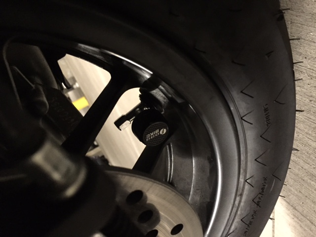

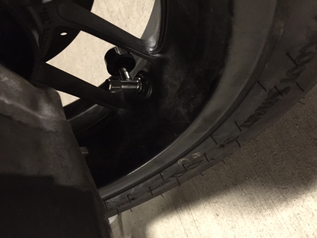

Hi All,
I have an update. I've successfully installed the FOBO Bike TPMS sensors on my Forza 300. Recall I posted a photo of the rear tire sensor coming very close to the transmission housing. FOBO states they want 1/2 inch clearance with rubber valve stems and 1/4 inch clearance with metal valve stems. I contacted FOBO and explained the sensors won't work on the Forza because of the clearance problem. They were fantastic to work with and suggested using their T-valves ($12 each). My Honda motorsports dealer installed the T-valves and rebalanced my tires. The T-valves are of excellent quality and solved my clearance problem. I mounted the FOBO sensors on the right-angle valve facing the right side (exhaust side) of the bike. They position the sensors away from obstructions and provide the proper clearance. I like having metal valves, and the T-valves allow me add/remove air from my tires without removing the sensors. I have them locked in place with the supplied locking nuts. Below is a photo. I checked the pressure accuracy with a high-quality tire pressure gauge, and the FOBO sensors are right on. I now enjoy seeing the tire pressure displayed on my iPhone before going for a ride. I also have handlebar mount for my iPhone, so I can see the tire pressure during my ride. I've searched for a TPMS and believe I've found the very best option with the FOBO Bike sensors. I highly recommend using them with the T-valves on the Forza 300.
- image2.JPG (75.36 KiB) Viewed 52027 times
