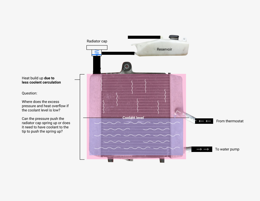

Re: Coolant over flow?
Thanks for the tips.
Question:
Where does the excess pressure and heat overflow if the coolant level is low?
Can the pressure push the radiator cap spring up or
does it need to have coolant to the tip to push the spring up?
Question:
- img 2.jpg (157.83 KiB) Viewed 4716 times
Its a sealed system there isn't an overflow.
The water pump shaft is a possible source of leaks, there's a weep hole under the water pump, if the water side seal fails coolant will drip from the weep hole.
PCX expansion tanks are known to crack due to faulty manufacturing, how is yours looking, is the cap on properly?
1) Doesn't matter if it's steam pressure or liquid coolant pressure. Any pressure in the coolant system which is over the radiator cap's rating will force past it into the overflow tank, no matter whether it's coolant or steam. Notice that the tube goes from the base of the radiator cap to the BOTTOM of the overflow tank.Can the pressure push the radiator cap spring up or
2) Likewise, when the engine is turned off and the coolant system pressure drops to a negative, the coolant that was previously forced into the overflow tank will be sucked back into the coolant system .... thru that same tube which leads from the BOTTOM of the overflow tank to the base of the radiator cap.
This 1) & 2) cycle repeats itself every time the engine gets hot and then cools.
Put some coolant in the overflow tank and see what happens to it. Does it leak out because the tank has a crack or hole in it? ..... Or does the tube that connects it to the radiator have a leak?
Also when you fill the radiator / coolant system, be sure to also 1/2 fill the overflow tank as well. That way, when the engine cools after the scooter is run and the coolant system / radiator hadn't been filled completely (and it was steam / that was forced out), it will have coolant in the overflow to suck back in instead of air.
