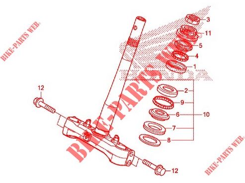

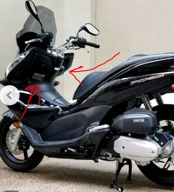

My PCX started making a knocking sound when coming to a stop at about 20,000 miles. The noise only got louder and happened more often. The bearings were good though, no binding like gn2 mentioned. After doing it the hard way of removing all the plastics and the handlebars to get to the top nut, I think there's an easier way. Since we aren't servesing the bearings, only tightening down the tension nut a bit.
You might be able to just remove the dashboard plastic covering the steering stem. Then you need to loosen nut number 3, just a bit. Then go about adjusting the tension on the bearing with nut number 11, like states in the workshop manual. Admittedly, I ended looking up some YouTube videos on how to adjust the tension on those bearings. After the tension is good, tighten down nut number 3.
After I adjusted it, the problem hasn't returned. Good luck

Gil wrote:My PCX started making a knocking sound when coming to a stop at about 20,000 miles. The noise only got louder and happened more often. The bearings were good though, no binding like gn2 mentioned. After doing it the hard way of removing all the plastics and the handlebars to get to the top nut, I think there's an easier way. Since we aren't servesing the bearings, only tightening down the tension nut a bit.
Thank you for that.
