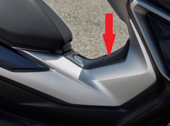

turned the switch to SEAT FUEL (7 o'clock) push the fuel side of the rocker that labelled FUEL/ SEAT
fuel lid remains closed
I cant get it to open :o

push the flap down slightly as you press the switch .....the dirt/grime '' gremlins are everywhere in this weather and can make these catches stick a bit

I carry a pocket knife just for that possibility. Sometimes the mechanical switch works but the door sticks. A thin screwdriver will also work. Push the fuel button while gently prying the door up.
If that does not work you may end up taking the plastic off that holds the fuel door and spraying some wd40 in/on the cable.

bearing in mind I have never seen this door open yet...... while gently prying the door up? from which side ? 8)

halluinoid wrote:bearing in mind I have never seen this door open yet...... while gently prying the door up? from which side ? 8)
Press the fuel flap button and at the same time press the plastic behind the hinge of the flap, it will open a few times then stop again.

Mel46 wrote:I carry a pocket knife just for that possibility. Sometimes the mechanical switch works but the door sticks. A thin screwdriver will also work. Push the fuel button while gently prying the door up..
:lol: SUCCESS! Mel46 I now carry a pocket knife just for that possibility
straight to petrol station, 10L straight into the tank, it's FULL and the vehicle is at WARP FACTOR 8, thanks to all, back in business :P 8)
