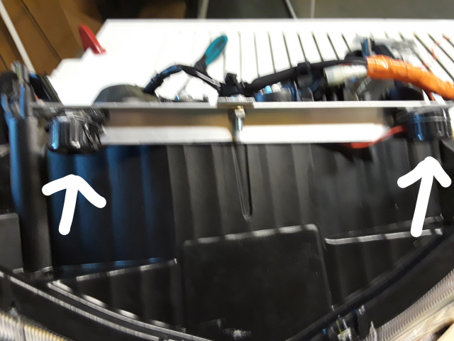

Anyone interested in attaching some baby strobe lights?
I just completed a modification on my wife's headlight assembly and decided to add some little strobe lights below the light assembly. They are cheap, but they do a nice job of getting other people's attention. They come on when the lights do, automatically.

I will be glad to do a How-to if there is an interest. As a teaser, here is a picture of the underside of my light assembly, and the strobe lights.
Excuse the jittery picture. The camera on my phone is slow, so if the assembly shifts the picture can get a little blurry.
