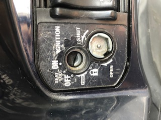

This is what it looks like. I have the key with the octagon, however, it has to be jiggled when I take it out. The other key without the octagon went in easily. I am in So Ca. The bike was made in Vietnam. I spoke with Honda Powersports and they do not know if it is a transponder key. So, they need to call the PCX expert, however, he is not in today. So, I am waiting to hear back from him. Thank you.

Before doing anything, I would go to a good locksmith and ask if he can clean up the key a bit so that it goes in easily (I've had several keys over the years that just had a rough edge that caught in the lock). Then you have to decide if you can live with only one key (when I got my 2013 the PO had lost one of the keys; I went ahead and had a new one made).
At first glance yours looks similar to the lock on my 2013. You can get blank keys on FleaBay for about $20 (e.g., https://www.ebay.com/itm/Blank-Ignition ... :rk:5:pf:1). When you get it, try it to see if it has the same profile as your existing key (a bit of a gamble there, but if it doesn't work, you're only out $20, which is better than a whole new lock). If the profile matches, a locksmith should be able to cut it to match your existing key for somewhere around $20. You will then have to fiddle with the little magnets that let the head of the key engage the hexagonal shutter release. There are only 16 possible combinations, so it's a bit tedious, but not that difficult to get them right.
