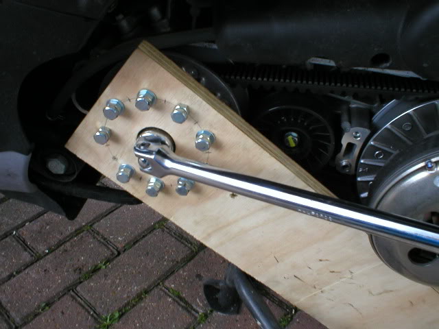

I've ordered a breaker bar and will try and make a different style variator holder - one with bolts in a circle that lock into the finns rather than the two holes. Searching google for this issue, someone said occasionally the nut is loctited on (hope not, had real problems getting my barr end bolts off as they had 1/2" red loctite on each bolt!)

Cut the corners off your home made tool and then bend over so they fit in the holes. Wouldn't really want to use the fins if at all possible.

It was seated well, but the bolts and bar both bent - bolt more so so would not trust it anymore. Seems the nut is really tight if not loctited :)

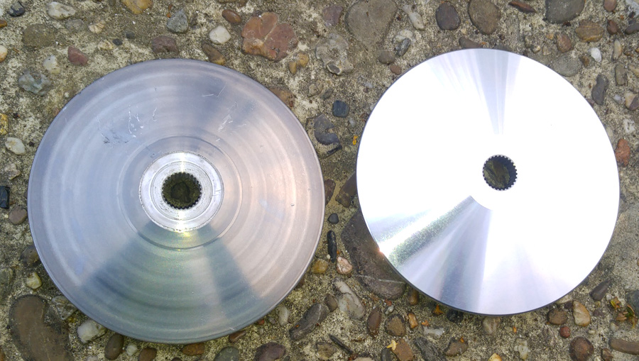

In order to do a proper maintenance you MUST get that nut out. Impact wrenches -forget about it. Get a proper Holding tool, i am using Buzzetti universal and it works fine. It has a tendency to slip at the bottom, just keep in place against the central stand with your feet while unscrewing the bolt. Do whatever it takes, try to unlock bolt after a ride when engine is still warm, put just a drop of penetrating oil... etc
You need to check your rollers, the sliders on the variator and the belt. Most probably if you have been just city riding for most of the time everything I mentioned is pretty much shot including your Face drive which will have marks on it. See below how mine looked at about the same mileage as yours ( same model, dec 2014 led). I decided to go for a J.Costa EVO 3 when i changed my belt at 24.000 km (you can now find them at 104 GBP on ebay.uk, a real bargain if you ask me). You will not know how smooth and what performance your pcx is still capable until you do this maintenance / mod.
Don't skimp- A tell tale sign that the transmission needs your attention is if PCX gets "jumpy " while idling on center stand. in the long run this puts strain on the crankshaft bearings and that you'll bitterly regret if they get shot. :cry:

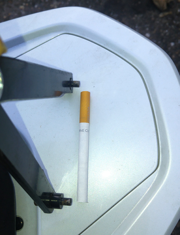

This is showing the studs i use for the variator:
Cheers

tomtomclub2005 wrote:This is showing the studs i use for the variator: Cheers
Mine looks simllar but the small 'studs' are shorter. The one that has the large mound behind it is about 3/4 the depth of the mound whereas yours look about 1.5 times the depth. Too short to be of use. Also they are only about 4mm wide whereas they should be 6mm (1/4" inch is ideal fit as 6mm is still a bit loose). Thanks for the pic.
