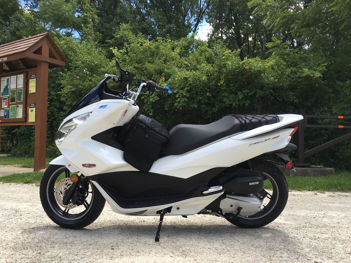

Mr. Chin is correct, you will lose 4 mph with those larger tires/tyres and that will lead you into variator performance add ons to get it back plus some. Your speedometer will also be 2 mph off because of the slight change in height. Benefits after both rubber and performance kit changes will result in;alx123 wrote:Take note, on stock vario, a 140 rear will be too heavy for the engine..
Over all speed and acceleration increase
Better comfort and stability on the larger rubber
Great look with the wheel wells filled out
and you get to join the Prestige club
- pose.jpg (578.06 KiB) Viewed 2774 times
