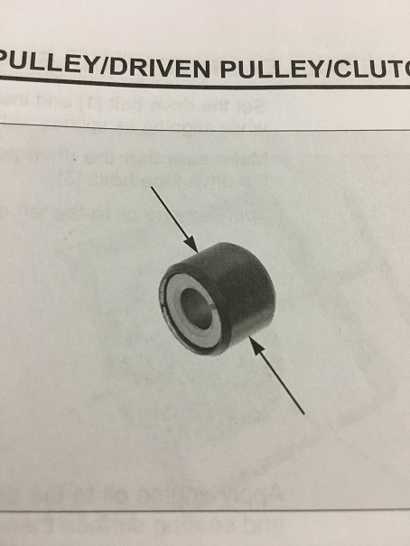

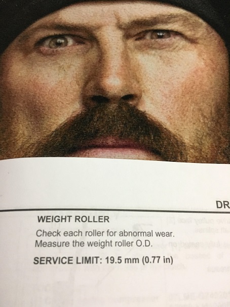

You back on the bus again eggman? You've a monkey now and can't stop tooling the bike? Most of us enjoy summer riding while it lasts doing this kind of work in the winter. I don't know about sliders but rollers are easily measured in diameter for wear and have a minimum service limit per the SM before replacement is necessary. You did mean to say sliders right?

Completely understandable, rollers, sliders, I thought they were talking about White Castle's the first time I heard about those pesky little things that fall out of my variator. Best you have rollers because as sure as shooting I'd be putting them sliders in wrong. And never mix the two because that's just silly.
unnamed (1).jpg (68.93 KiB) Viewed 720 times
