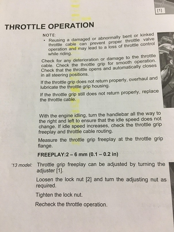

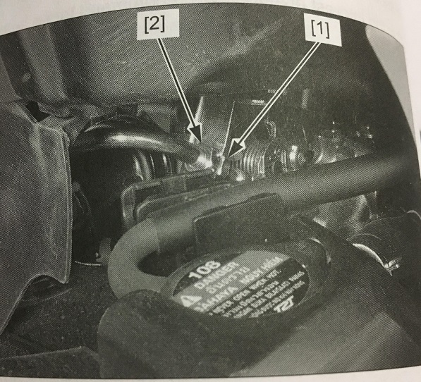

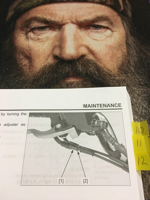

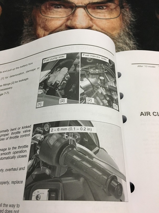

I have a bit of play in the throttle and like to know there is a way to adjust to remove the throttle slack?
Re: Throttle slack
The good news is your 13 model is the fastest PCX, bad news it's so fast Honda had to hide the adjustment down by the radiator
After 13 it's up on the throttle housing where no amount of adjustment makes it go any faster
- unnamed (3).jpg (150.11 KiB) Viewed 8326 times
- unnamed.jpg (175.26 KiB) Viewed 8326 times
- unnamed (2).jpg (153.28 KiB) Viewed 8326 times

The second pic helped and I was able to remove the excess slack. Thanks! Where did you get the manual from? Pouring rain here as well or I would be out riding
