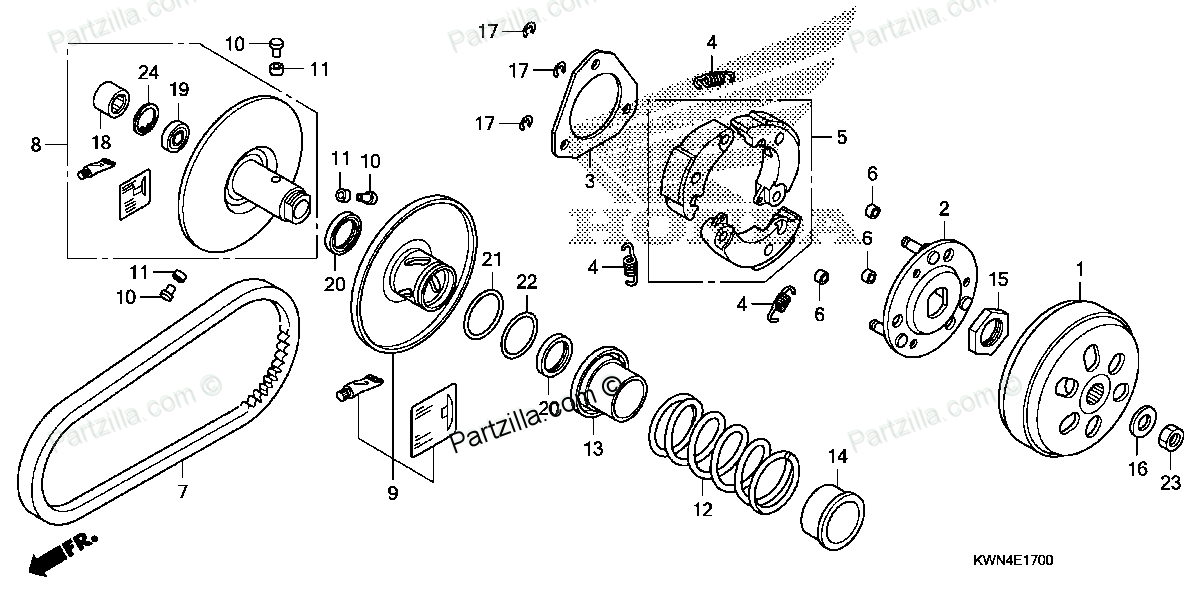

Just pulled the variator and clutch off for an inspection as it was making a "rattle" noise on the over-run at between 10 & 20 mph. The bearings 18 & 19 in the diagram looked good but no.19 had hardly any grease in it at all, couldn't tell if it was like it from new or the grease worked out. Stuck plenty of grease in it, as well as in bearing no.18, and shall keep an eye on it. ;)
The "rattle" noise could be that a few of the variator rollers had flat spots, which didn't seem very good after 5657 miles. Anyone got experience of roller wear as it's my first CVT scoot! :D

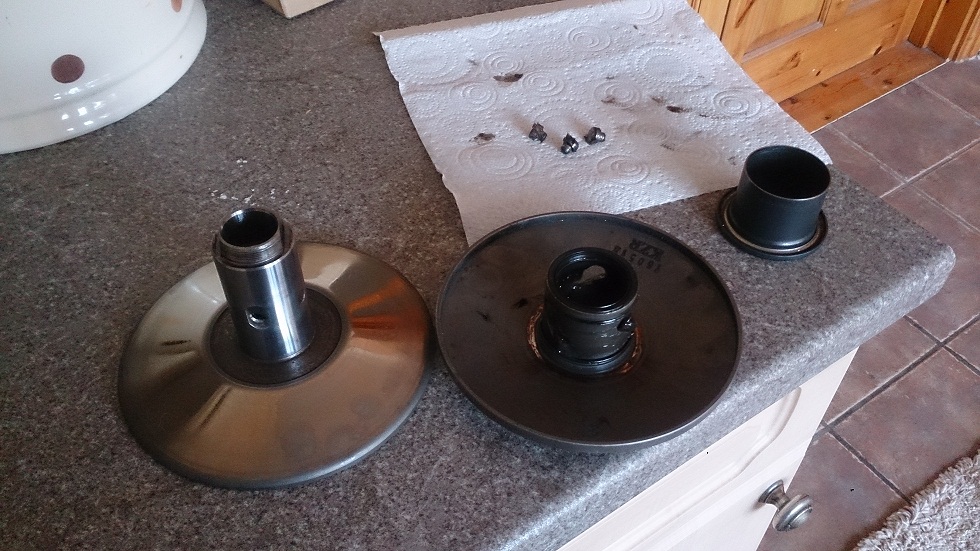

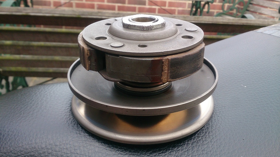

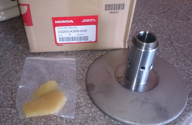

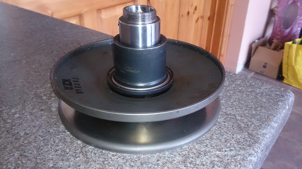

Part arrived at last after nearly 4 months, i have installed it and all is quiet from the variator housing now! :D :D :D
Here are some pics
