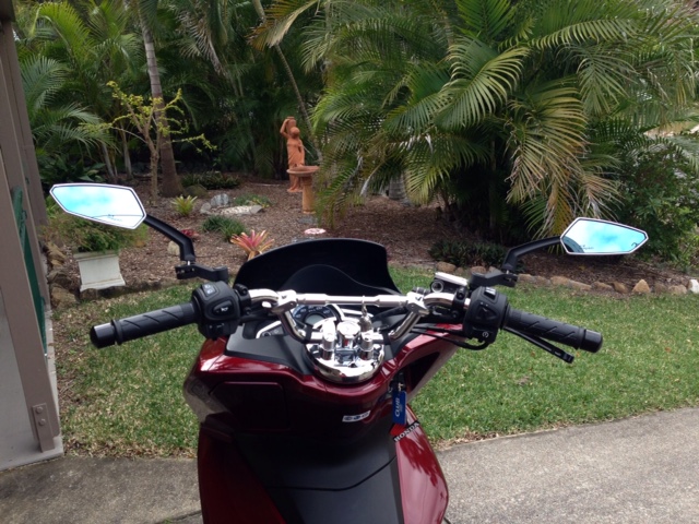

Mirrors 2.jpg (162.32 KiB) Viewed 7520 times
I have these fitted to my PCX and think they're great. Slightly less vision than the standard mirrors, but if you use your neck as any motorcyclist should, you won't have any safety issues.
Magazi Tulip chrome universal motorcycle scooter mirrors
Item Number MG-1876-Tulip-chrome $49.00 USD
(kiwavinternational@gmail.com)
Price may have changed as I bought them 12 months ago.
