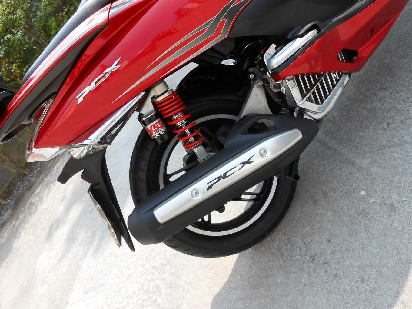

Re: YSS shock plus more ....
...I think these YSS shocks look the best on a PCX...........
- pcx - 2 005.jpg (259.4 KiB) Viewed 24392 times
They do look spot on tbh
