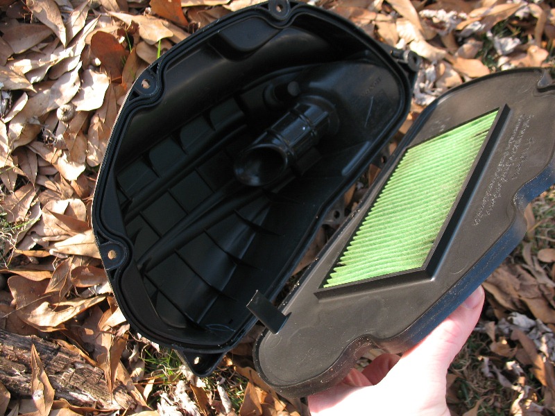

Remove the 8 screws around the airbox. It should fall right off.
The air filter just rests inside the airbox, and is wedged in there without any screws. It should just lift right out.
Place the new filter in:
Line the airbox and filter back up and screw the airbox back in place.
All done! It should have only taken you 10 minutes or so. ;)
