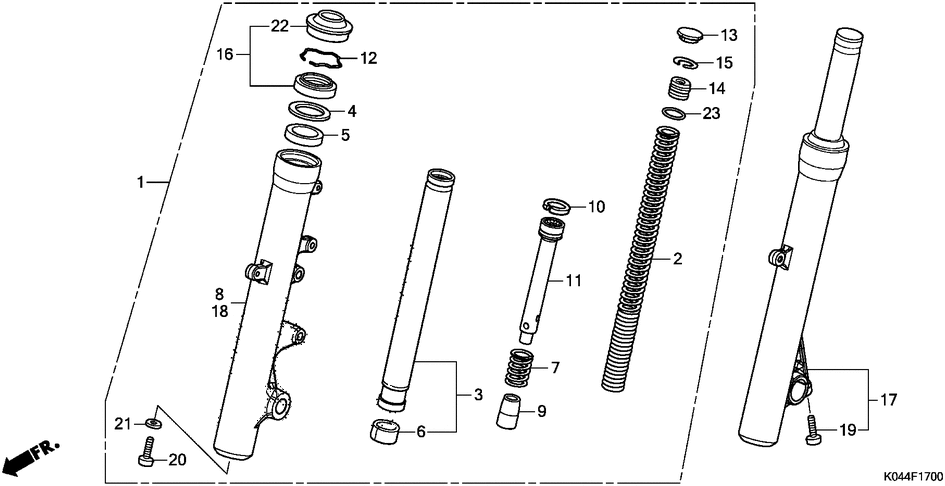

Addition please find a picture from the forza parts manual to see the items involved:
- itm. 13 plastic cap to remove first
- 14 spacer to be pushed down
- 15 circlip to be removed
forza front fork.gif (46.47 KiB) Viewed 11070 times
Hope it helps.
p.s. The whole thing took me net 45 seconds. I suggest to use the search function next time - many issues had been discussed before on this board.

How come the spacer comes out by pressing it? Do i need to press only the spacer or by pressing the inner pipe? Thanks

The assembly is held together by the force of the main spring pushing the spacer to the circlip, what is herefore locked into a groove inside the tube. By pushing down the spacer inside the tube (without pushing the tube itself) one essentially releases the tension on the circlip, which can be removed and the whole assembly can be freed up. It is a lot difficult to describe than actually doing.
Here is a link to a video, where Vlad (a.k.a. PCXdemon) shows how to change the front spring on the PCX. The Forza fork is slightly different, but the removal and reassembly procedure is essentially the same.
https://www.youtube.com/watch?v=_UtGWZGX1jk
It is however helps a lot to have somebody around to remove the circlip and place it back on reassembly if you're not used to do it.
And for the love of god, please find a more suitable tool than a knife to remove the circlip. It just don't seem to be safe on the video.

Well thats easy. Just a bit of extra strength to push it down
