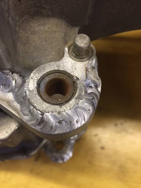

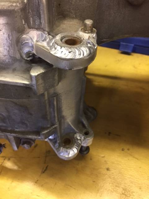

So I got the crankcases welded up at the stand mounts. One side had completely broken and whilst the other side was fine, I got both sides strengthened while the engine was out. Had an aluminium strip bent to follow the outside of the mounting and had it all welded up. Hopefully this will last but I will still only be using the centre stand for maintenance and fuel fill ups.
Got the engine back in now and I have done the valve clearances while it was out.

Look fine. Who did it for you?
- Posts: 6103
Re: PCX125 Centre Stand
nice welds... good job!

It was the guys at the link you provided Alibally. Thanks for that, although they normally make bespoke motorbike frames.Alibally wrote:Look fine. Who did it for you?
I should have taken the injector out though, as the fuel inlet has snapped off some time during the welding. Hopefully ebay to the rescue.

Well I have been using the PCX for the last year commuting. Been used most days come rain or shine. I do an annual thorough check over and I took the stand out to grease the pivot.
I can confirm the repair is holding fine, but then it's probably a lot stronger than before. I have used only the centre stand as I wanted to make sure it was ok (it's also much more convenient using the centre stand to fill up etc.). Happy with the fix.
