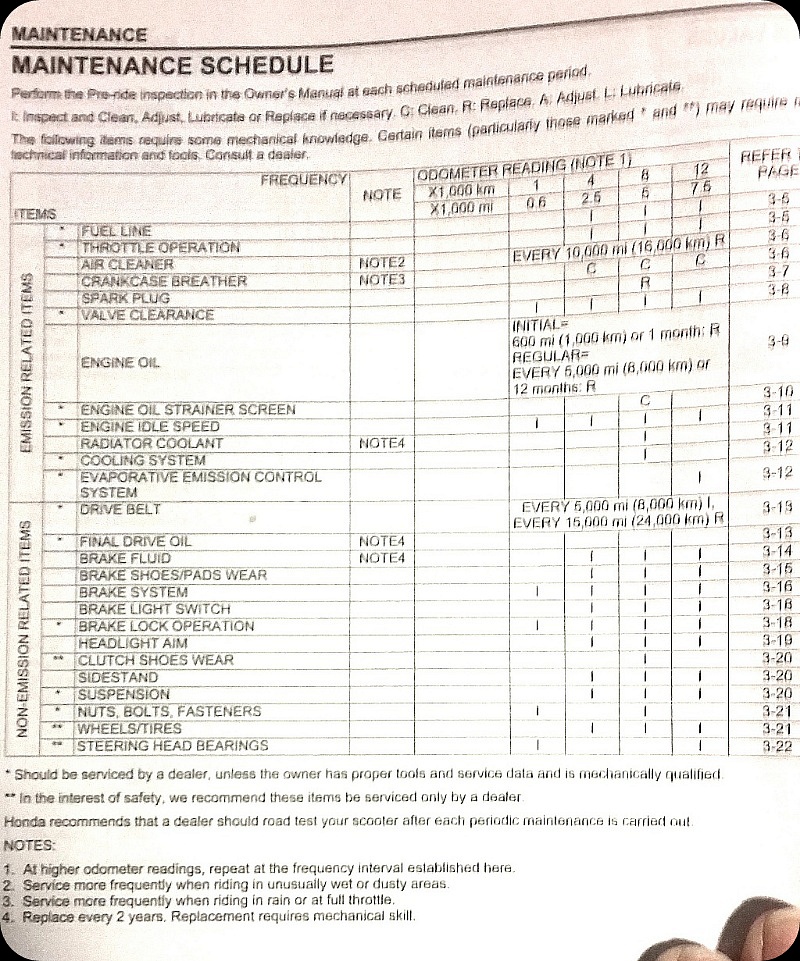

Re: 600 miles service check up
2013 maintenance sheet.jpg (373.08 KiB) Viewed 6043 times
This is the maintenance schedule for my 2013 model PCX. I know that the newer ones have some changes, but this should give you an idea of how much really has to be replaced during these visits to the mechanic.
I = inspect
C= clean
R= replace
Mel46 wrote:I believe it is called a screen, not a filter, so you don't have to replace it with a new one. You can pull it on the first and every other oil change after that. The first go around there will be some small metal particles in it from break in. After that I doubt that you will find anything in it, but go ahead and rinse it out ever so often. It still only takes an added minute or two.
Strainer screen according to your manual :D
